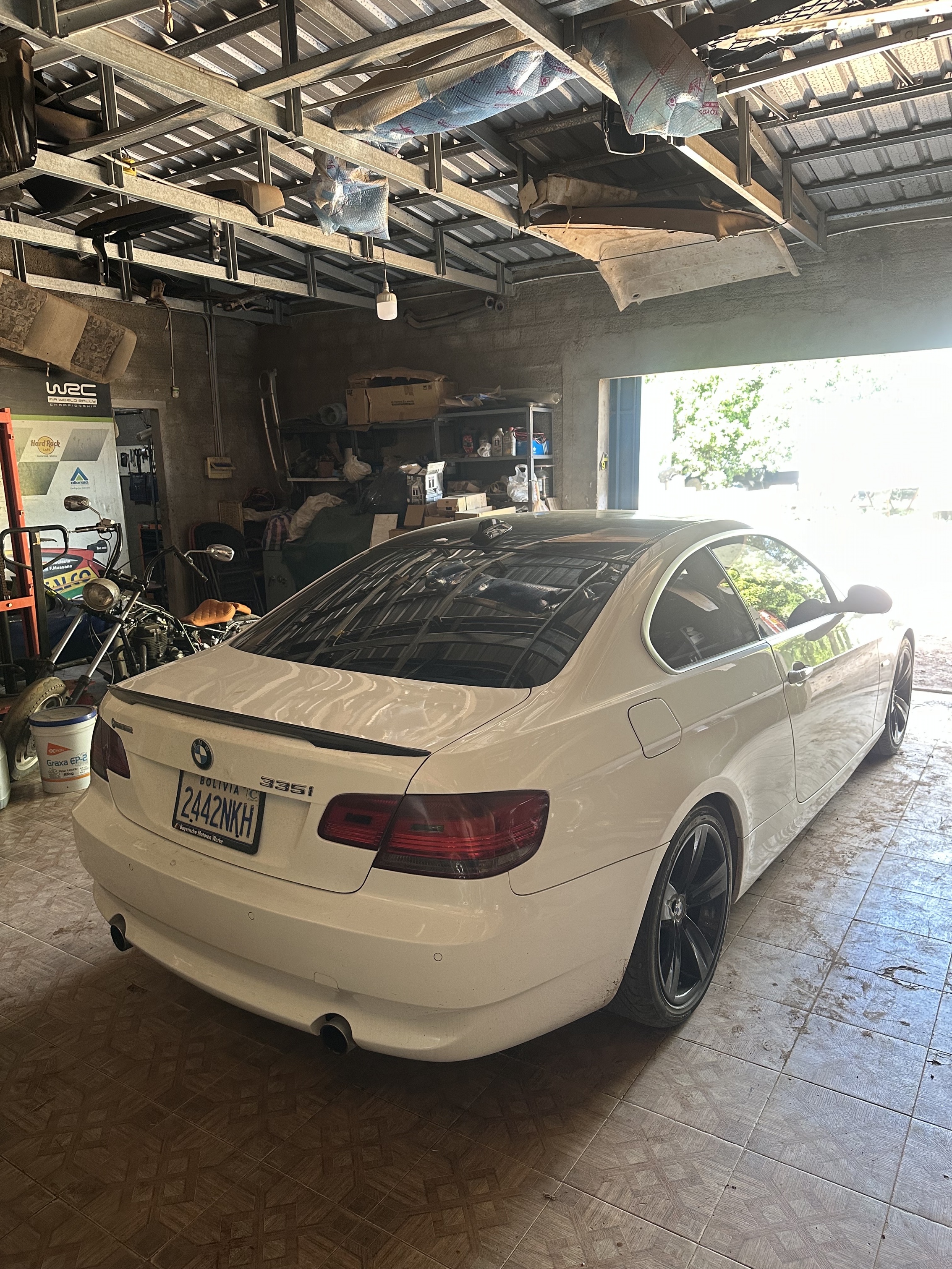

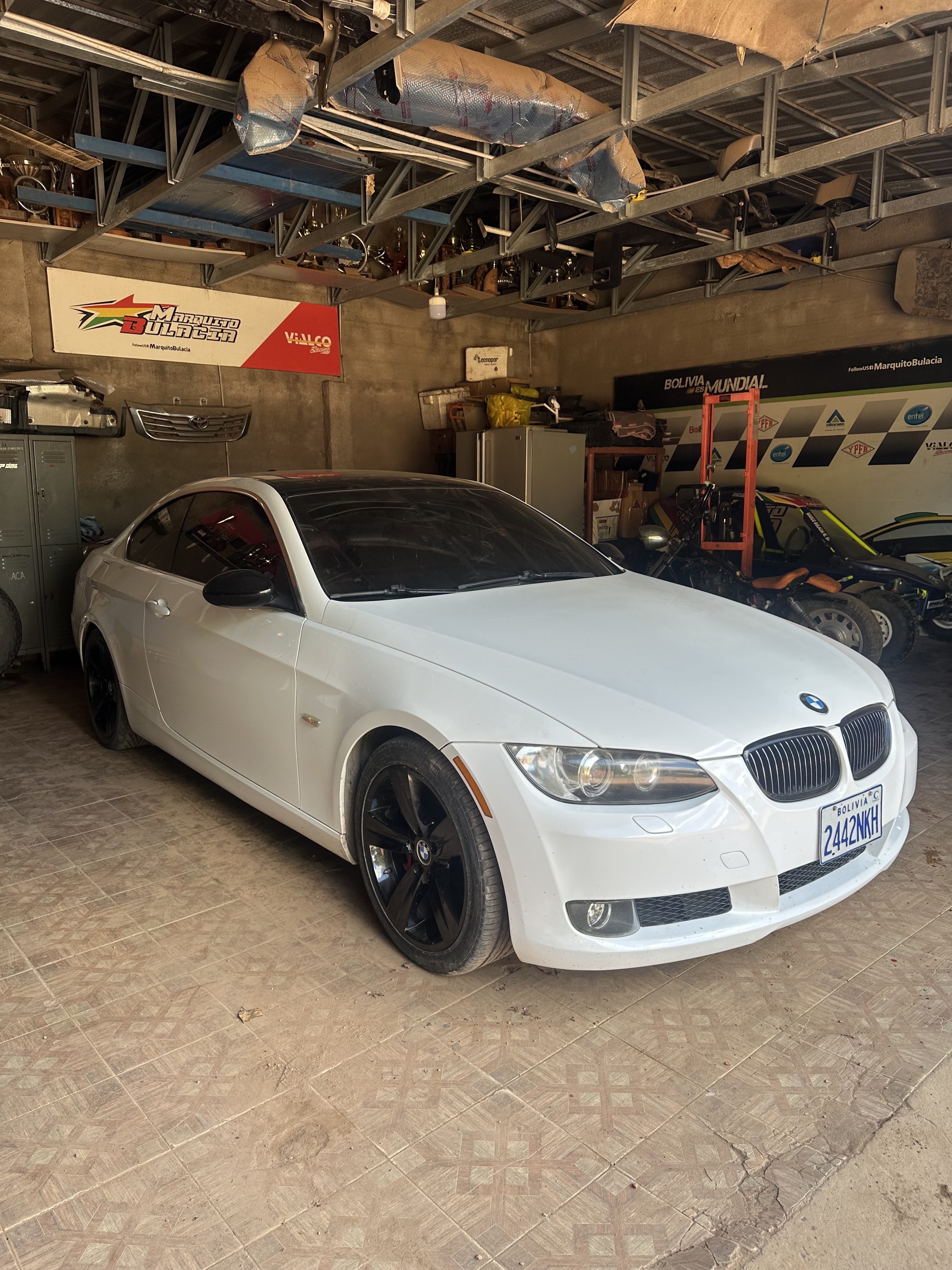

Hi guys,
I'm building my BMW E92 335i N54 to be a comfortable daily driver but also capable for weekend drifting. Reliability and balance are the main goals.
I’ve already purchased about 80% of the parts, but before finishing the build I’d love to hear if anyone with experience in drift or track E9X cars would recommend adding or changing anything.
